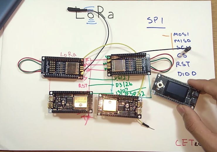

Step 3: Connections and soldering
1. Solder the modules with the stackable headers.
2. You will need to connect both the LoRa modules to the ESP32 modules according to the wiring diagram.
3. Gather all the 5-6 modules that you will be using and stack them according to your need of the Radio. For these steps I highly recommend watching my video as this part is explained in detail there.
